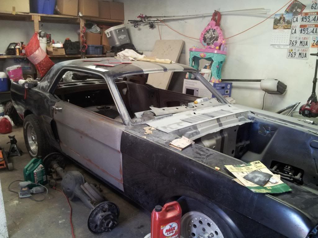

1966 Mustang Coupe (Under Construction)
Motor: 4.6L 32v out of an 04 Mach 1 (55K miles)
Trans: TR3650 5 speed
Rear End: mustang 8.8 (Disc Brakes)
Front End: Mustang ii Style (Disk Brakes)
Interior: None yet but will be using 04 mach 1 or GT front and rear seats
not a lot of room left over but it will work

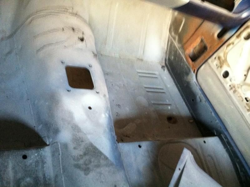

new floor boards
