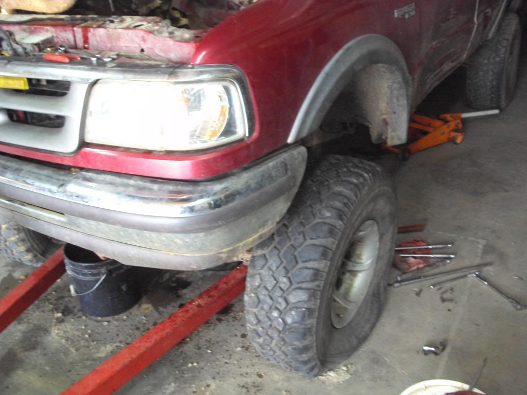

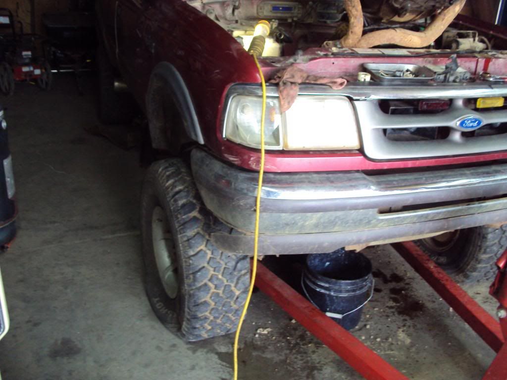

My truck has too much lift for an engine swap, had to let the air out of the tires….For those that remember my truck, it had 37's on it, this swap was done with it sitting on 33's…

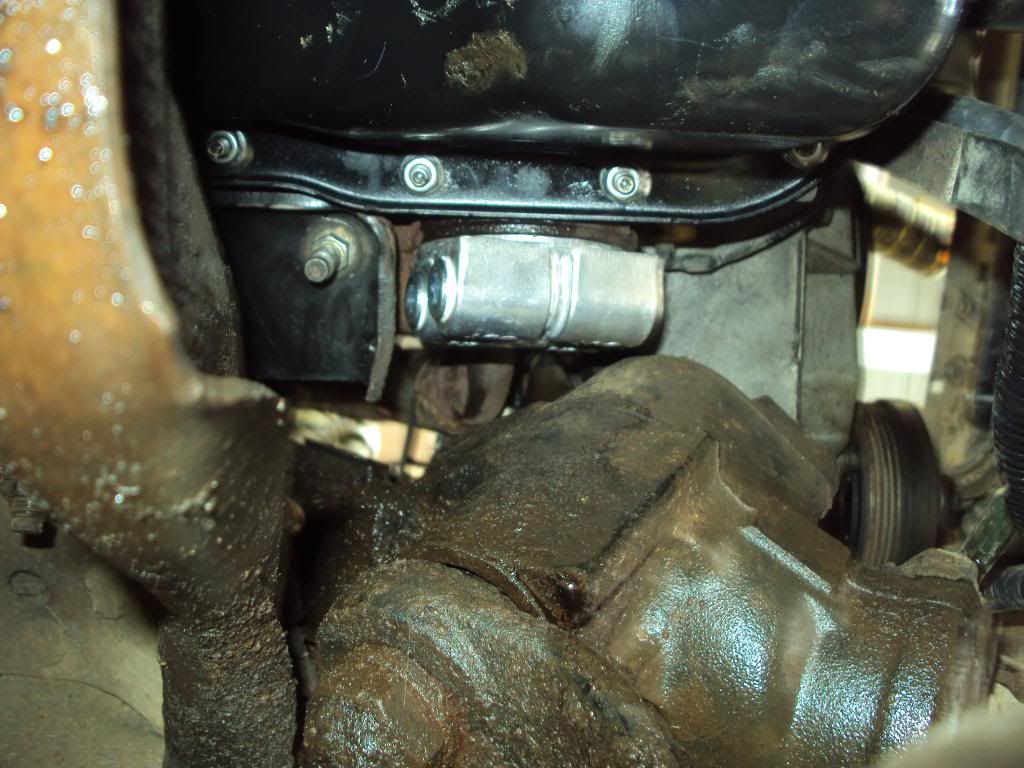

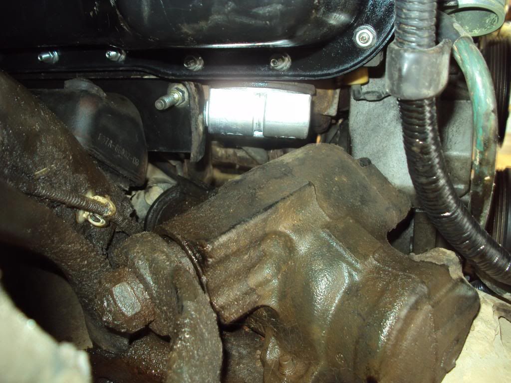

Another mod needed is to remove the oil filter thread adapter located in the block. This is what the oil filter screws onto to secure it to the block. The explorer block is set up for the oil cooler, which has female threads instead of male threads so the stud can attach the oil cooler to the block. This is easily removed with a 1 ¼ socket. If you use an adapter from another block, you will find it difficult to do as there are no flats for a socket to fit on. I searched around the shop for a nut to fit on, found a castle nut that was the same thread size, cut off the tabs of the nut and threaded it on along with the original adapter onto the oil filter stud from another block I had and using the two jammed together I was able to back out the stud and thread it into the explorer block. You might be able to source a replacement stud from a machine shop or NAPA, but I have not tried, I just used one from a block I already had. Any stud from a Ford engine that uses the FL1A style filter should work. Summit racing has these also.
Once this is done, it's time to install the oil filter relocation housing. Be sure to get the correct adapter, like THIS (http://www.summitracing.com/parts/TRD-1413/) one. As I found out, it's best to install this with the engine out of the vehicle, as I had to lift my engine back up, and remove the mount to install the housing. In these pics, the engine is in the truck, but lifted to install the housing…
In these pics, the engine is sitting on the mounts…
I wanted to point the outputs of the housing straight forward, but there was interference, so I had to point them down. This pic is from underneath…

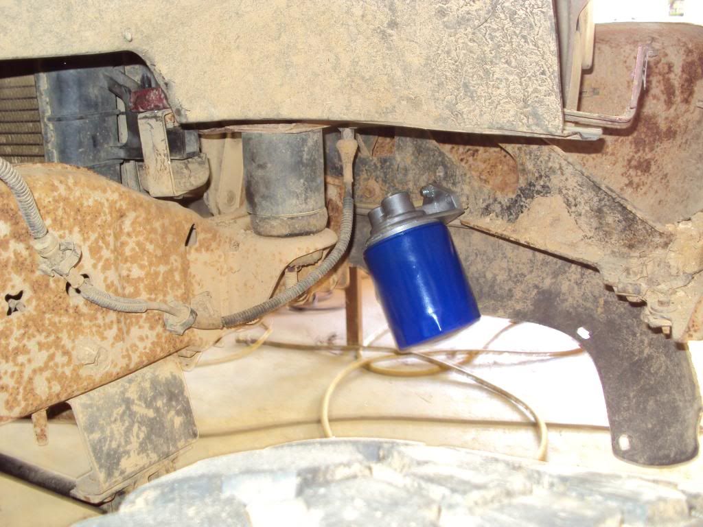

I opted for the dual filter setup. When you buy your kit, plan on where you want your filter to be mounted as you only have 30" of hose, so it has to be within 30" of the housing on the block. I mounted mine to the factory bumper bracket. If you want to mount it elsewhere, you will need to get longer hose, available at your local hydraulic hose shop. Bring the hose with the kit with you, so you can get the right type of hose, this hose is not expensive and won't cost much for what u need. There is room to mount it to the lower core support, but for my application it would be in the way of my winch that I am mounting later. The current mounting location is temporary as I will be building a new bumper, and incorporating a mount into that to further protect the filters…

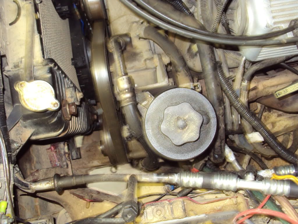

On top is the explorer power steering hose, the ranger on the bottom. You can see the difference in length, and the explorer hose needs to be used. However, the ends are different on one end, which is the gearbox end. The explorer uses a rack and pinion steering, not a gearbox. This is easily solved by a trip to a hydraulic hose shop and having them cut the end off and install a regular 90* 3/8 inverted flared male fitting. There is enough room on the hose for the shop to do this...
UPDATE 3-22-12
Although I can't personally confirm this at this time, I have been told a 96 f150 power steering line is a bolt in swap. It has the correct fittings on both sides...
The return line is next. I will be changing this setup in a couple weeks as I am adding a hydro boost setup as well as a filter and cooler into the system, and later will be adding hydraulic ram assist, but for now I did this to show what is needed for the swap. Here is the filter I will use. I also plan to use one of these for the transmission as well. Again, this is mounted temporarily until I build my bumper in a couple weeks…
I used the ranger return line and modified it. I tried to bend it without loosening it, and winded up kinking it at the gearbox, so I had to cut the kink out, and use my tubing bender to make a couple bends in it, then flare the end. If you loosen the fitting at the gearbox, you might be able to reposition the hose and bend it slightly by hand into location, then trim the extra rubber hose at the reservoir…

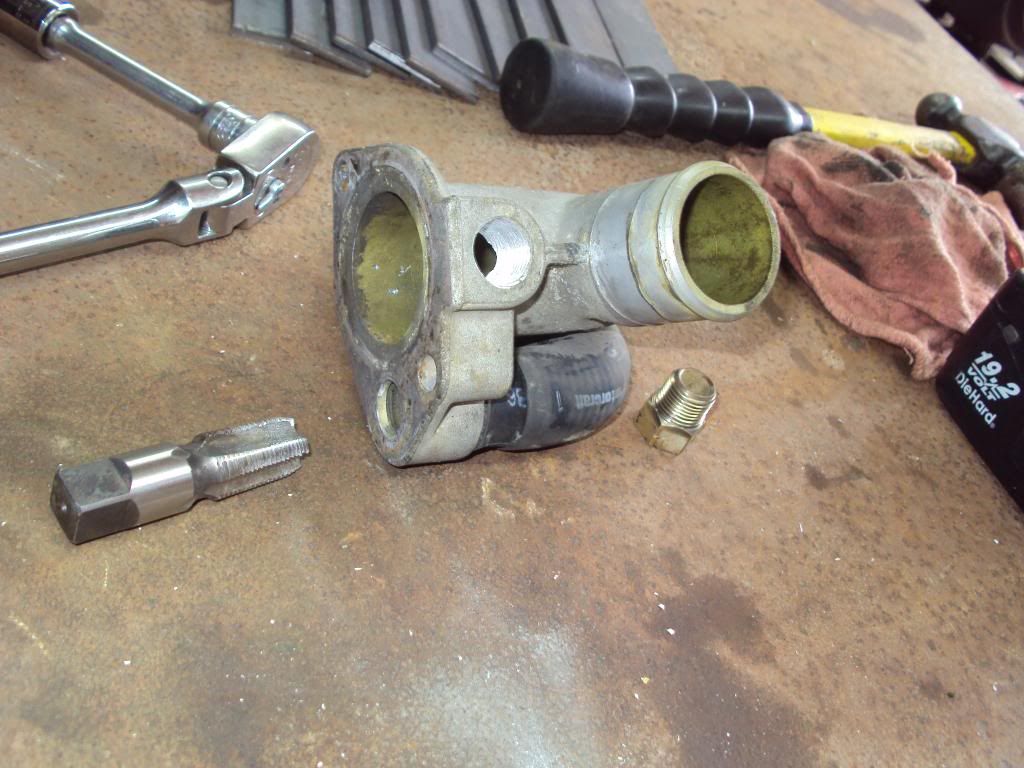

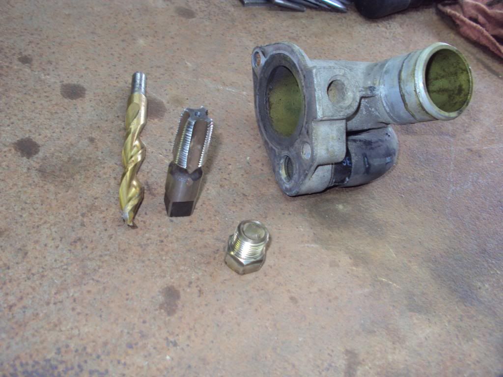

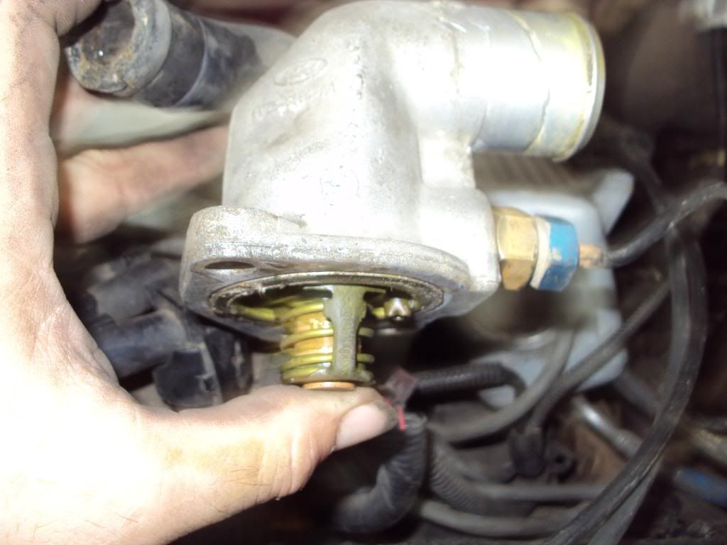

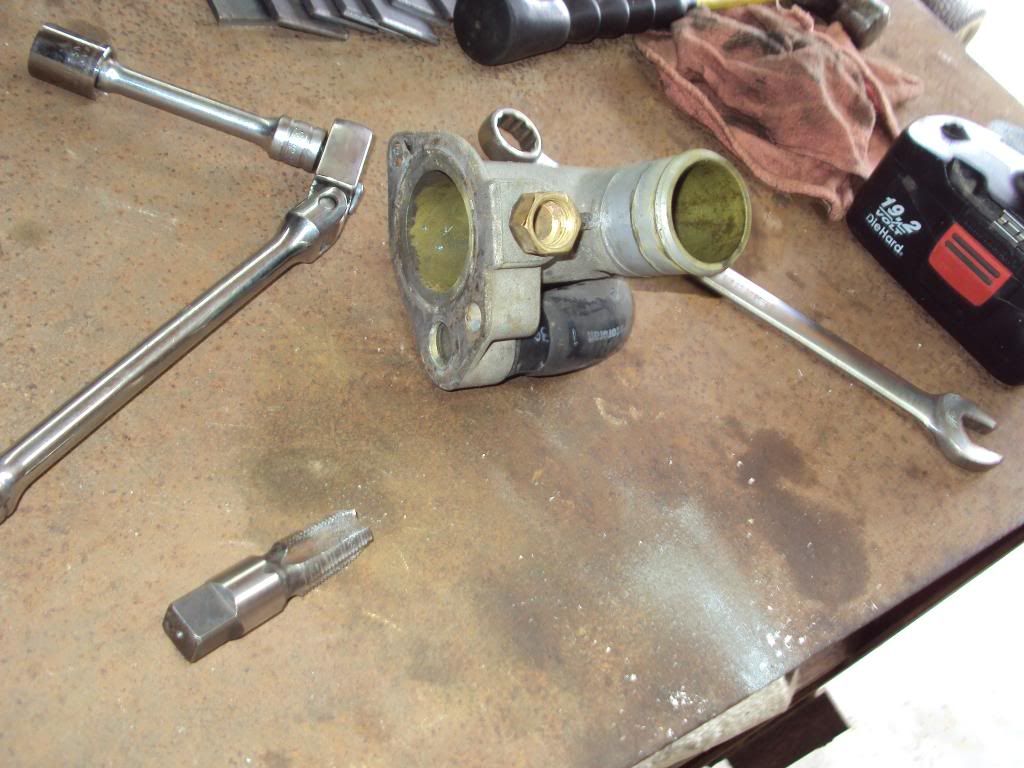

While not needed to perform this swap, I have a mechanical water temp gauge installed, and needed a location to put the sending unit. I chose the thermostat housing. Before everyone posts up that it's on the wrong side and will give faulty readings, I already know this. To give me slightly better readings, and to prevent trapped air in the cooling system, I drilled a 1/8 hole in my thermostat, and located the hole right where the sending unit is located. I used the old thermostat for mockup and fitment purposes, and replaced it with a 180* thermostat prior to final installation…

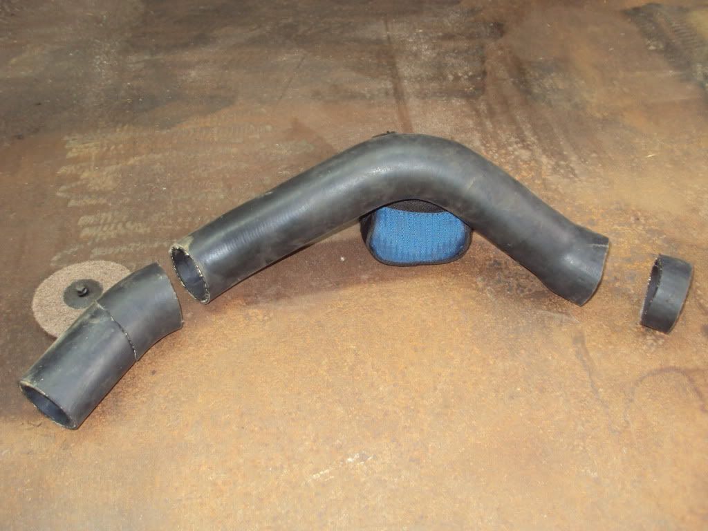

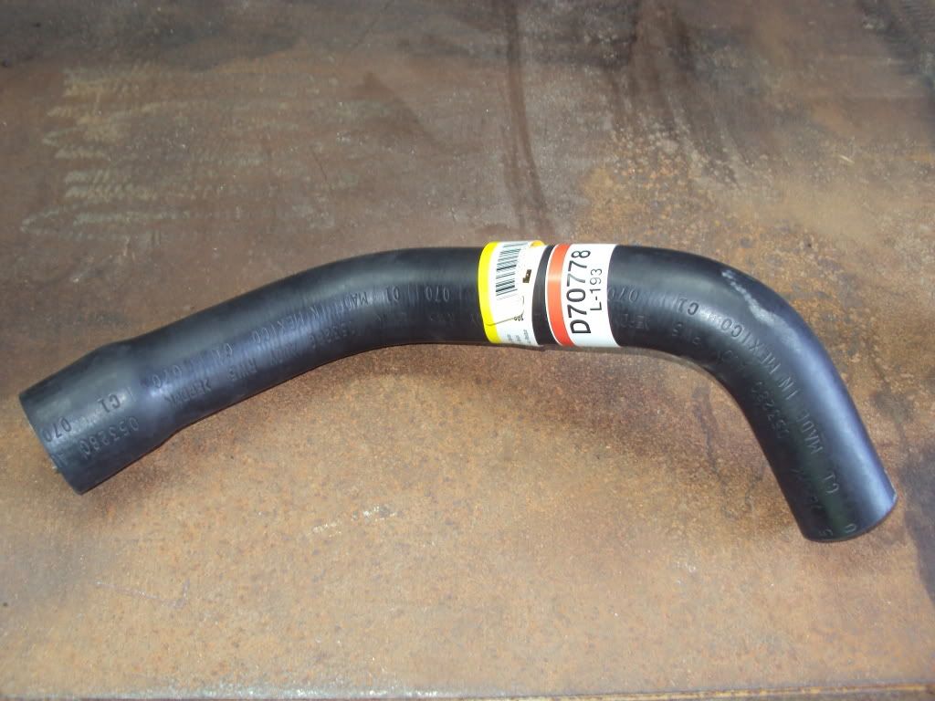

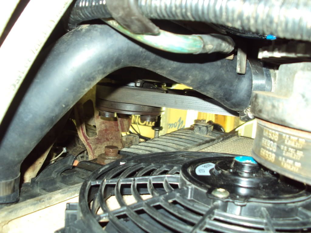

The upper and lower radiator hoses...The upper I used the explorer hose with no mods, the lower I used an 89 mustang 5.0L lower and trimmed a little on each side and it fit pretty well...

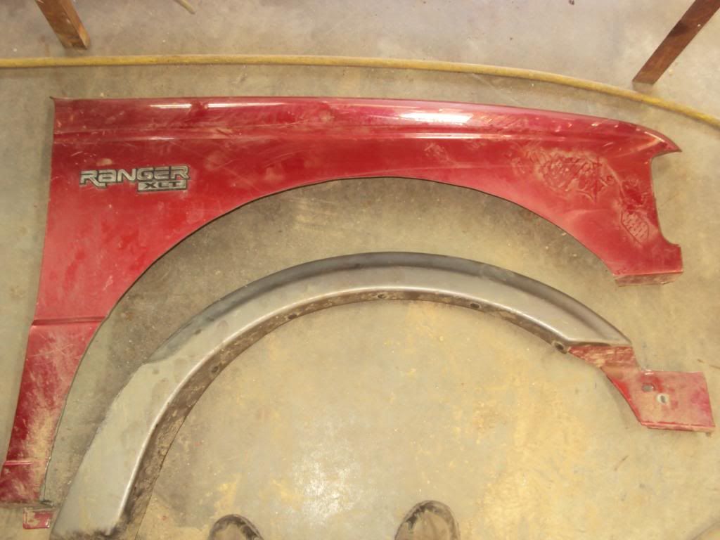

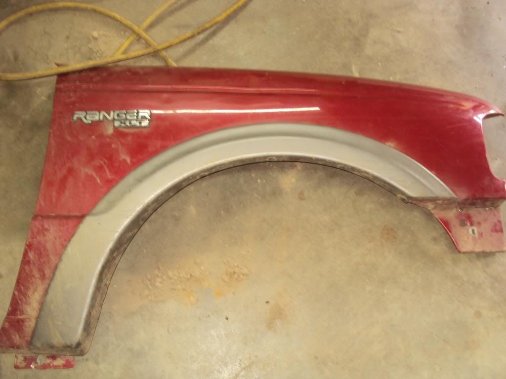

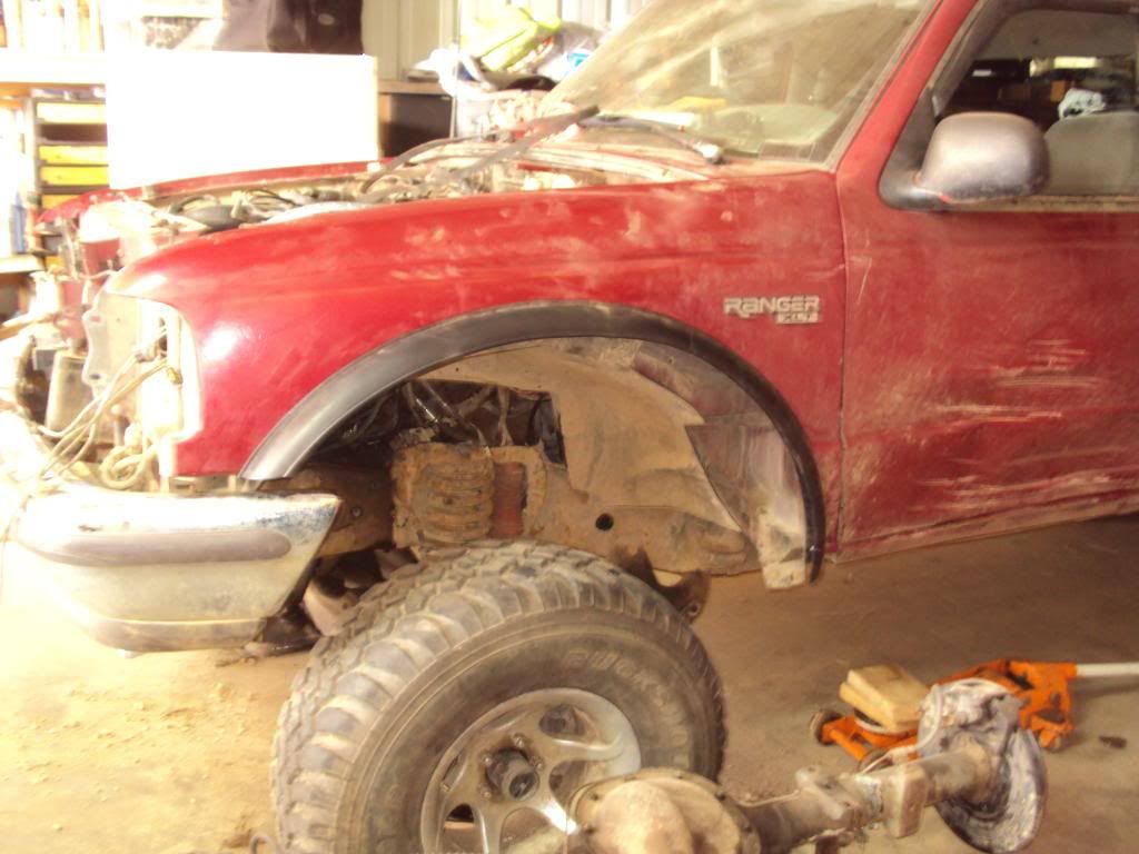

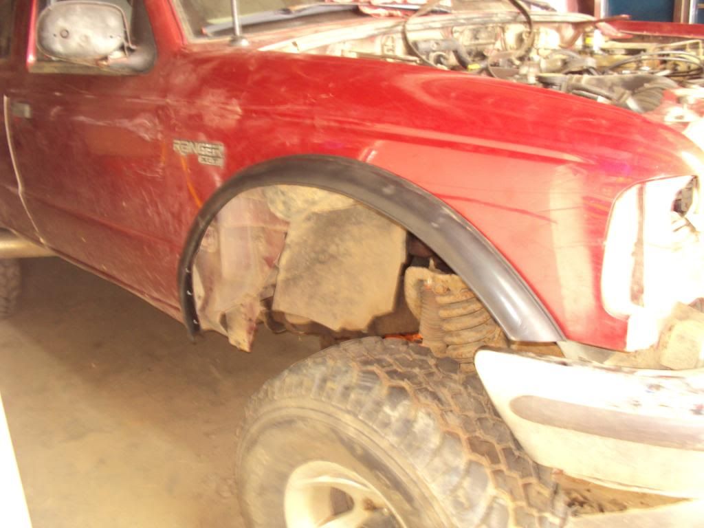

Not part of the swap, but for more fab work, I cut my fenders while doing the swap as I already had my fenders off, and installed a new fender flare I found, they are made of rubber, so they won't break or tear out on the trail, plus they look pretty good too…
